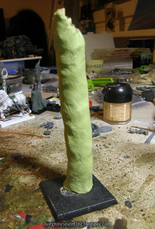

Then I cover the stick and try to spread the mix around to make it relatively even all around. The thicker this layer is, the more definition you can sculpt on the tree.

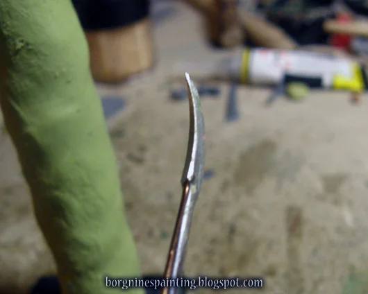

Now it's time to use sculpt some vertical ridges on the bark. I use a sculpting tool you can see below, the producer called it 'a scythe'. A knife can be used too, I use this tool to give those ridges a bit of width. That makes them easier to work with in the later stages.

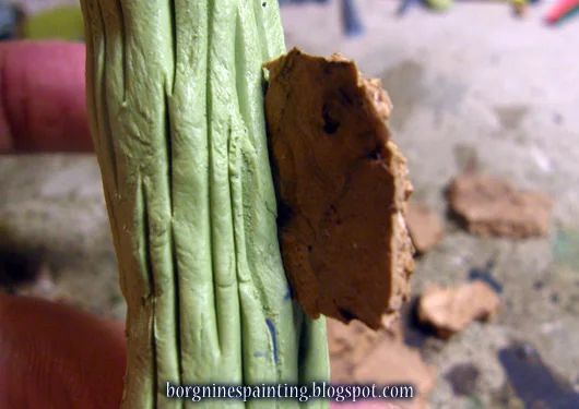

And now it's time for the bark texture. For that, I am using various pieces torn off a cork mat:
proxy.php?image=https%3A%2F%2F3.bp.blogspot.com%2F-inUQ25FOfLU%2FWyOdAIe1qfI%2FAAAAAAAAB3A%2Fx3wd8luSzC8ZDwS6t3yDHsn2TeyuWipmACLcBGAs%2Fs1600%2Fdrzewo06.jpg&hash=4a16608628b08b88489a90caa39e5b32
I wet the pieces with some water to prevent it from sticking too much and I press them against the bark, trying to line one of the cork edges with the existing ridges.
proxy.php?image=https%3A%2F%2F2.bp.blogspot.com%2F-HsMdais5Bbc%2FWyOdAQfophI%2FAAAAAAAAB3E%2FD-7Qw0O2nNwfovqIdoGkqOmuczMq7ijnQCLcBGAs%2Fs1600%2Fdrzewo07.jpg&hash=75df829259addb7842cb79c9ab3f4526
This gives it a random, bark-like rough texture. I try to turn the cork piece or switch them often to keep the pattern from repeating too much.

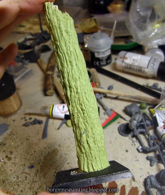

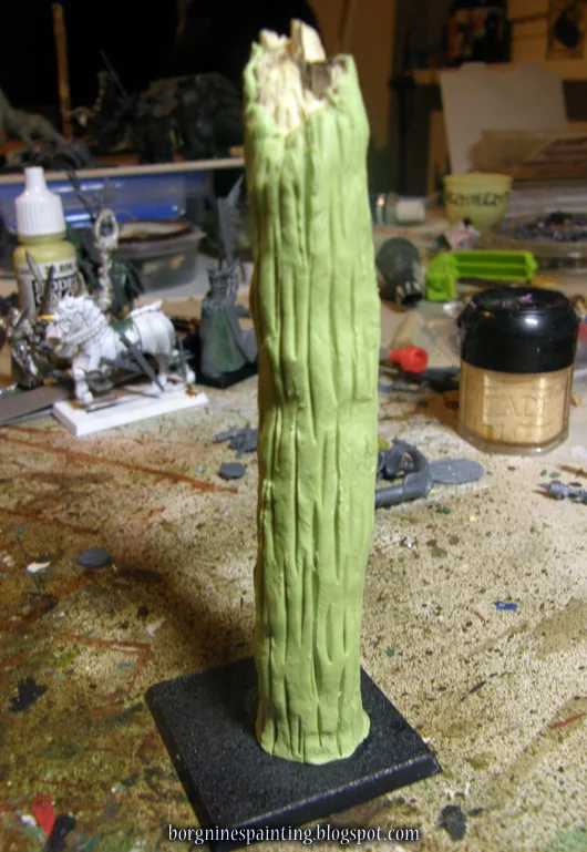

Here you can see the bark texture mostly sculpted:
proxy.php?image=https%3A%2F%2F2.bp.blogspot.com%2F-IhPPLvQp4R8%2FWyOdA5zyJyI%2FAAAAAAAAB3M%2FORfYhGMv9nY5ndpkqr5gyIjZnbFCCwtKQCLcBGAs%2Fs1600%2Fdrzewo09.jpg&hash=ae82b19268a755b1b06ddc1e5d8c3c44

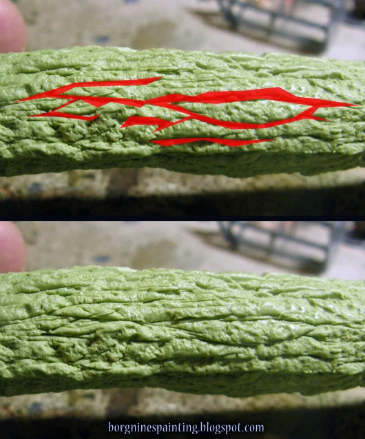

Now it's time to deepen and emphasize the ridges, to simulate many pieces of broken bark sticking to the wood of the tree. Earlier stage, even if performed very carefully, tends to cover up some of the earlier ridges so it's good to bring them back. Not to mention separating them a bit. For this, I have been using either a scalpel or the 'scythe' tool pictured earlier.
proxy.php?image=https%3A%2F%2F3.bp.blogspot.com%2F-mSejoiyDOXw%2FWyOdBLnxPQI%2FAAAAAAAAB3U%2FqA-K1GlBUgs2vio4TiqpsSPwxZtR2q5tgCLcBGAs%2Fs1600%2Fdrzewo11.jpg&hash=e63f816ab8b70d3ae94972f733ae3cda
I try to sculpt elongated cigar shapes interlocking with themselves. On the left is the idealized version, the principle that should lead the sculpting process - and on the right how it should mostly look in the end. This time it's important to distinguish many separate parts of this cracked bark, in opposition to the continuous, vertical surfaces seen before texturing.

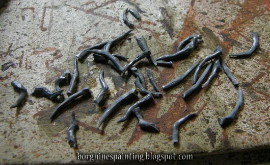

And because wooden twigs break off easily, I tried to do some of them out of plastic. The easiest way would be to take branches that come in a Dryad box, for example. Those didn't fit my needs, though - I wanted long main branches with smaller pieces sticking out of it - that's why I made some of my own!
I start with a slightly curved piece of leftover sprue. I found ones that are 2-3 cm (or about 1 inch) long tend to work the best. Still, longer ones can be shortened easily and are easier to carve, so it's always better to cut them longer.
proxy.php?image=https%3A%2F%2F3.bp.blogspot.com%2F-AWBU0S4fkaM%2FWyOdCsXXIUI%2FAAAAAAAAB3s%2FikpZg-j4aMoKpO2mzDoRJhXEgz6SMIeAQCLcBGAs%2Fs1600%2Fdrzewo17.jpg&hash=4213b909fca64f7fb60f3c8b43deaf09
Using a scalpel or another sharp knife, I begin to shave the sprue away, switching from side to side and thinning them down, tapering to a point at the end.

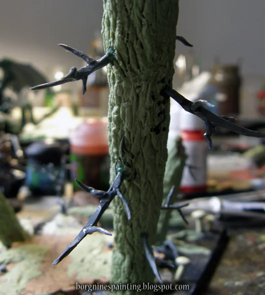

Instead of sticking them into the bark while it's still soft, for these branches I drilled holes in the tree after the mix has already cured and glued them inside with some superglue. Any gaps that remained were covered up with greenstuff. Like earlier, they should be set at different heights all around the tree.
proxy.php?image=https%3A%2F%2F2.bp.blogspot.com%2F-gG_P2xpkyXc%2FWyOdDKW7sAI%2FAAAAAAAAB30%2FIm9VdwrJv944q_nTBSaQnl7COa2G0kI9gCLcBGAs%2Fs1600%2Fdrzewo19.jpg&hash=1a018e35c7c038dd02f4d1969bfed450

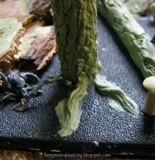

If you want - that's optional - this is a good time to add some roots going around the tree. For ones that look like here below, I made some rolls out of the same Milliput / Greenstuff mix that the bark is made of and stuck them on the ground. After that, I smoothened out how are they connected with the ground and sculpted them a bit with a round, pointy clay shaper/rubber brush.
proxy.php?image=https%3A%2F%2F1.bp.blogspot.com%2F-Xy1WOY5lBKo%2FWyOdCnlVfLI%2FAAAAAAAAB3o%2FPidvPnLRqRYlRATD262cN0-YtIM3dp4_gCLcBGAs%2Fs1600%2Fdrzewo16.jpg&hash=8be0589f9f856d21fb8e78e9413911cc

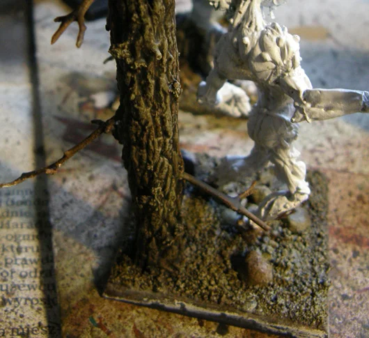

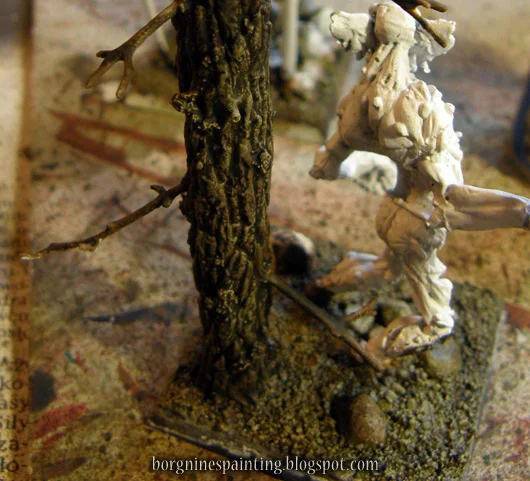

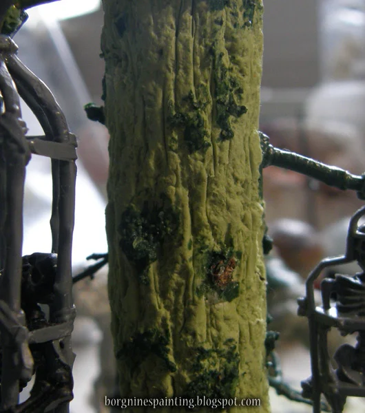

And that's it! The tree is ready and it should look similar to the one you can see below (painting-wise of course, the height of the tree may differ of course!):
proxy.php?image=https%3A%2F%2F4.bp.blogspot.com%2F--QODnfqZqZU%2FWyPptG5mu1I%2FAAAAAAAAB5U%2Fmgo_spUWXYQAZ5pG_Yuh4Wj3rVGanTIggCLcBGAs%2Fs1600%2Fdrzewo32.jpg&hash=111d7ff70a06e0eefcd6741a2e9ddf71
