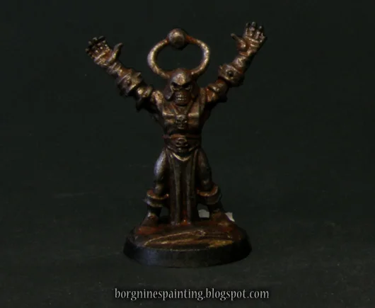

Shortly after I posted my Faceless Stormcasts, I got asked about the recipe for their armor and to make a tutorial about it. It was still pretty fresh in my memory and I even wrote down all the steps, so I thought 'why not?' - this will be yet another of many rust tutorials available on the internet. I know it's relatively long, but I think that all the steps are important and affect the final result - and it is probably actually simpler than the number of steps would suggest.

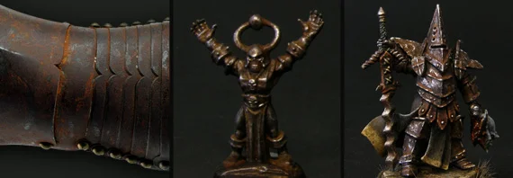

The photo with the effect that I was trying to recreate can be seen above, on the left picture - the whole thing is supposed to be dark and messy, with some significant rusting, while keeping the overall metallic look.
The miniature used in this tutorial was an old Chaos Sorcerer from Warhammer Quest. I got him a long time ago and I didn't really have any use for him before, so I decided to turn him into a statue here, seeing that his pose is static enough for this purpose.

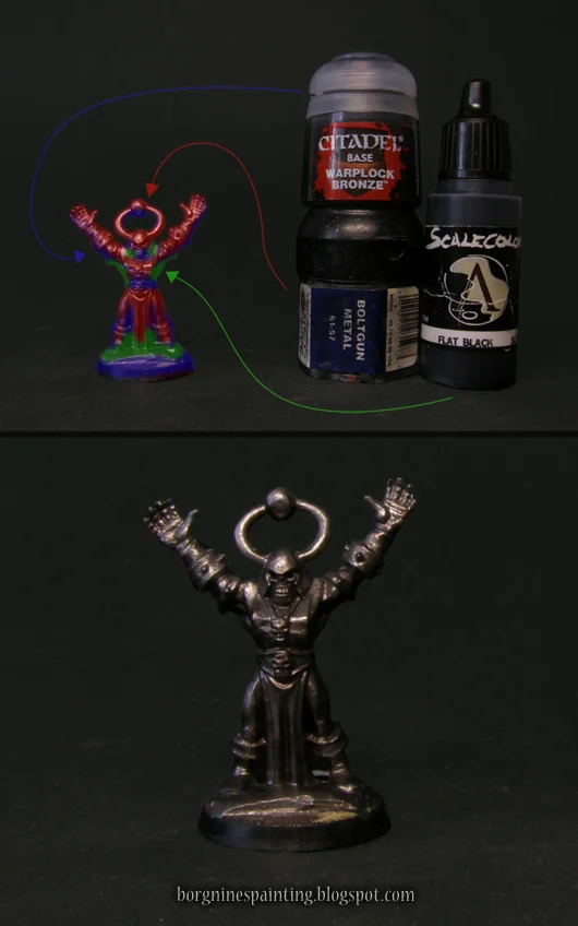

I started by painting a base of wetblended Boltgun Metal from GW (which is known today as Leadbelcher), Warplock Bronze and some matte black. The blending itself was quick and messy, no need to be smooth with it. The parts that can be seen from above were painted dark silver, bronze was used on the undersides and then black added to the most recessed and covered places. Making it lighter from above and darker on the undersides helps to create the illusion of light coming from above. This arrangement is shown on the picture below.

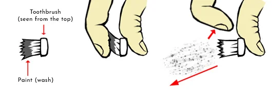

Next step is sprinkling with a toothbrush - a method that I have been using for years and which always gives some great messy randomness to miniatures. For anyone unfamiliar with it - I do it by putting the brush in the wash, wiping the excess on the inside edges of the pot (it shouldn't be dripping!) and then flicking the finger on the bristles while pointing them at the miniature - it will spray the mini with random droplets of the shade. Explained much better in a picture below (note how the direction of the sprinkle goes slightly below the direction of the brush's bristles):

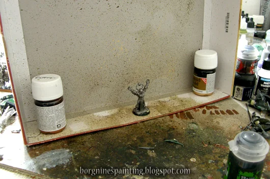

It's always good to do the first sprinkle at something else than the miniature, to test if the amount is good - sometimes it's too wet and sometimes it doesn't even fly off the toothbrush. Obviously, this method is very messy and it's good to have something behind the mini to protect your workplace from becoming all splattered with paint. Here is my setup:

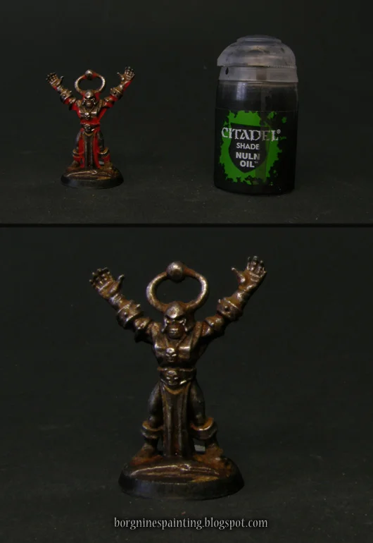

Here is how it looks after sprinkling first with Nuln Oil, letting it dry and then sprinkling it again, with Agrax Earthshade (red dots on the picture above simulate the sprinkling).

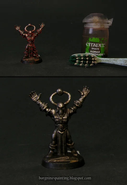

Now is the time to bring back some of the metallics. I do this by stippling the areas marked red (generally all the exposed areas, especially the ones that can be seen from above the mini - once again, simulating the light with brighter areas on the mini). Stippling is like drybrush, only instead of brushing the mini, you hit it's surface vertically from above and the brush has slightly more paint in it than your typical drybrush. I use for this a synthetic brush with the top part of the bristles cut off, making it flat and perfect for this task.
proxy.php?image=https%3A%2F%2F4.bp.blogspot.com%2F-tEYDmU_UdK4%2FXLsAA04hXvI%2FAAAAAAAACgo%2FIwRDHutP3JwMva0cA5gC0x5uJ_GjiBYeQCLcBGAs%2Fs1600%2Ftut_page3_small.jpg&hash=9006988f2e6314dab82f715dff8b2ad6

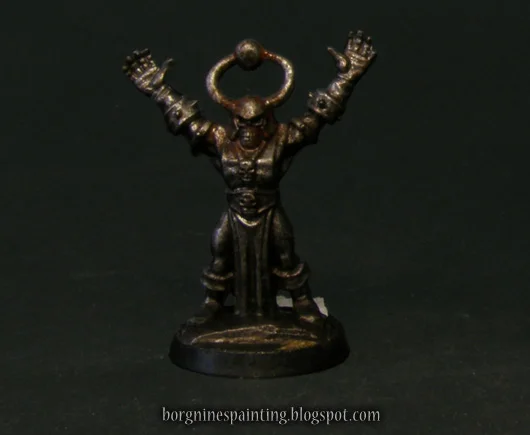

To avoid making it all too clean I sprinkled the mini once again, this time only with Agrax Earthshade.

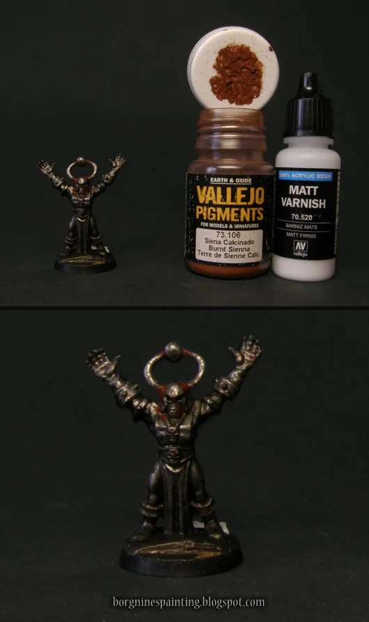

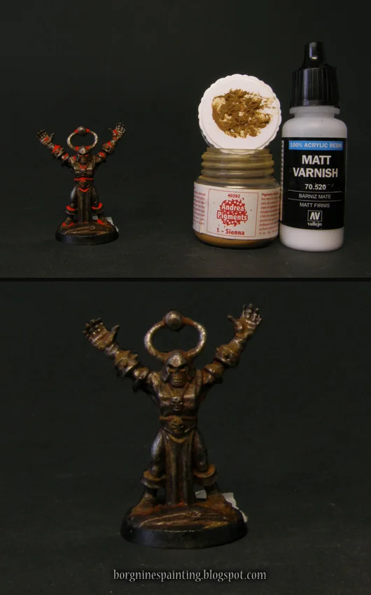

Now it's time for some rust! For this, I am using two pigments - one for old rust that's gathered on most of the areas and is very weathered and another for much fresher rust. First one is Burnt Sienna - I am using Vallejo, but other companies' pigments should work the same. I mix it in 1:2 proportion with Vallejo Matt Varnish (needs to be shaken really, really good, can come out glossy if unshaken). After mixing I take an old and tiny brush and put it in large(ish) blobs in all the recesses. Seen below, only around the head:

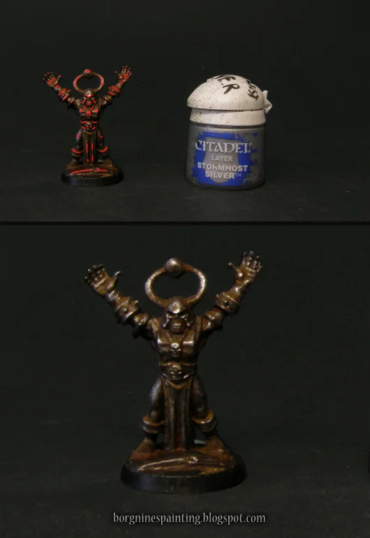

Now, the highlights. I used Stormhost Silver, but any other bright silver can be used instead - and because of how bright it is, it should be used sparingly. I applied it as an edge highlight on the most raised areas or as tiny dots on the rivets and other pointy details. As before, shown below in red how I used it:

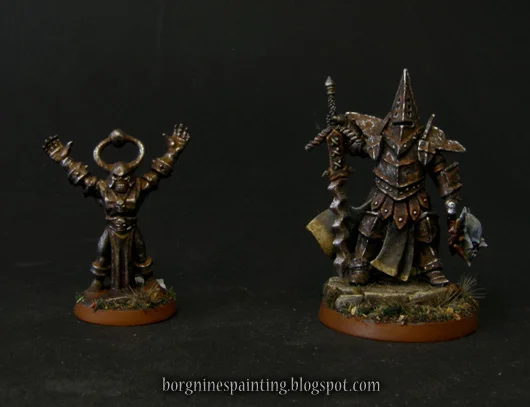

And that's it, the rusted statue is ready. I based him and set him beside the Crusader from the warband that started this whole rusted scheme. This brave chaos sorcerer will be used as a marker in my games - and if I ever need him in some more responsible role, I will just strip him and repaint him.
