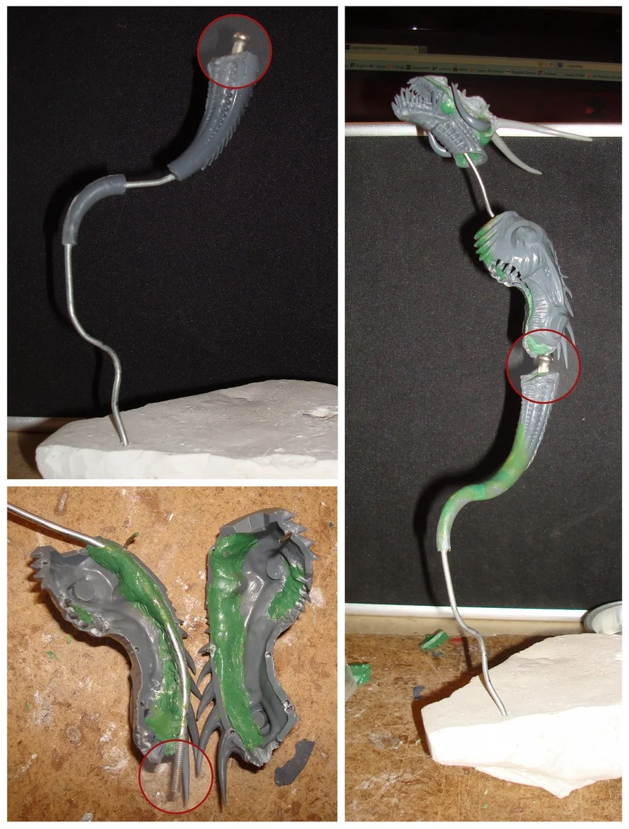

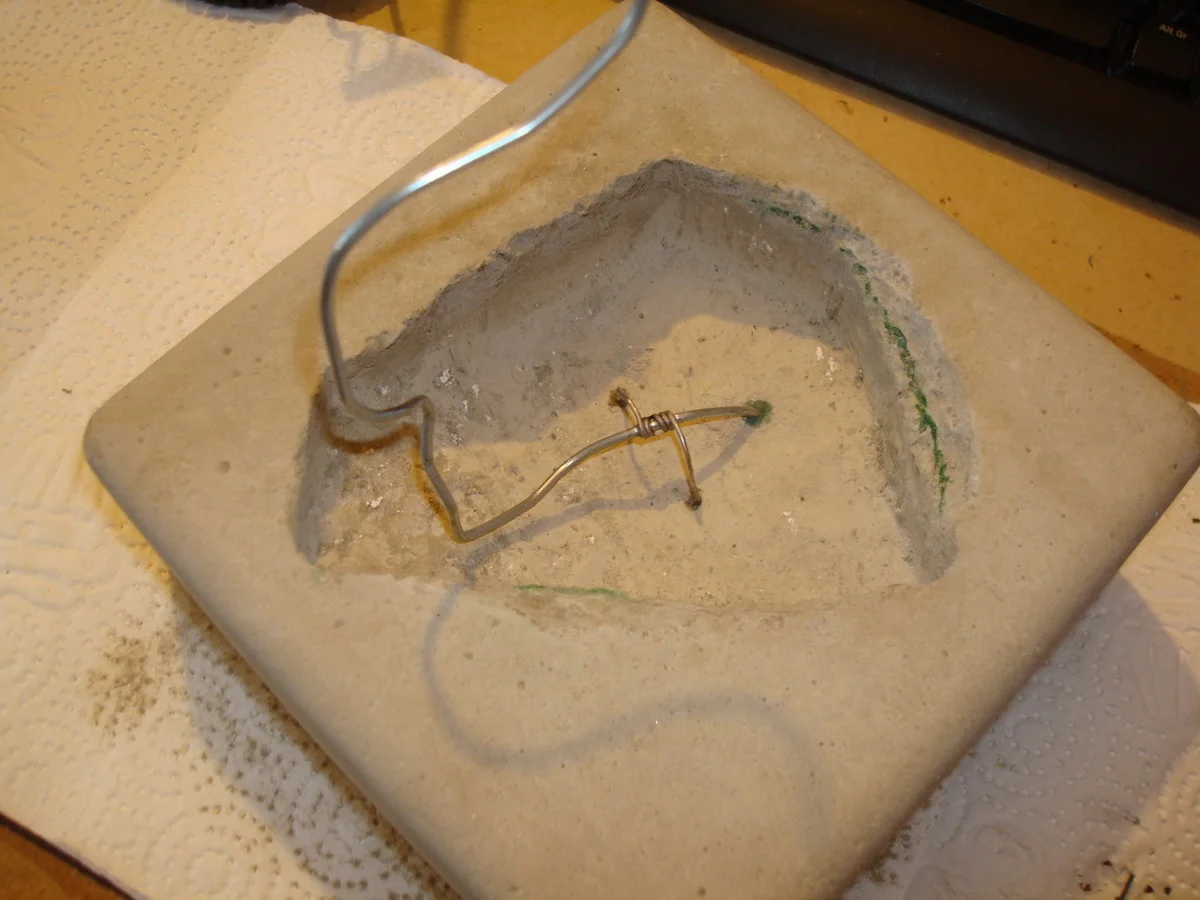

It is indeed a steel pin. A steel bicycle spoke to be precise. Well, two of them in fact, connected with a spoke nipple. :perv: I think spoke is one of the best things I could have used for the cause, as it is thin and very strong. It is also ductile which prevents it from brittle fracture. First I had to bend the pin/spoke in a desired shape (the one that would fit through the body of the CSM used as the Vampire Lord). So I carved a channel through the torso and the leg of the CSM (that miniature, coming in two parts, was perfect for the job) and bent the spoke to fit in. Oooh, that was fun...as said, steel is very hard. xD. Here is a photo to show what I mean:
VLord_zps846679cd.jpg~original
With the spoke bent in shape, I then applied it to the concrete mold made for the plaster cliff. Once the spoke was in position, the plaster was poured around it (with added bits of lead to make it heavier) and the spoke was set in place.
DSC06047_resize_zps29478e98.jpg~original
The spoke was only long enough to pin the tail part...luckily, as spokes come in pairs, they have a connection mechanism (threads & nipples). So I took another spoke, which goes through the body and all the way to the head. They are then screwed on together at the tail/body connection part. Also had to make sure that the body was facing correct direction once it was totally screwed on.
Body_zps8bebb0ac.jpg~original
So, that's pretty much how it works...and I can only hope it will continue to work and withstand the perils of time & battlefield! ;)

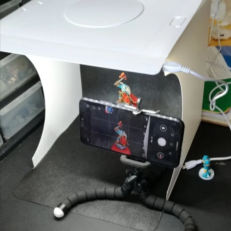

Not sure if I've done any Vampire Counts related work since my last post, but might as well resurrect this old thread of mine in the spirit of the new awakening of CN. 🙂 After WHFB went down, I switched to smaller scale games like GW's Necromunda and Blood Bowl and AMG's Marvel Crisis Protocol. I've done some conversions and panting in said games so will eventually make one log to share all of my stuff that isn't related to WHFB.
In the meantime, here are the newer pictures (and even a gif!) of my old Wight King conversion/paintjob. The photos were made last year and show that you can make a decent setup for photographing miniatures without a big investment. I reckon the photobox, tripod, rotating stand and remote shutter release didn't cost more than 15-20 € combined, and the smartphone isn't high end either.
Reactions: Kassill

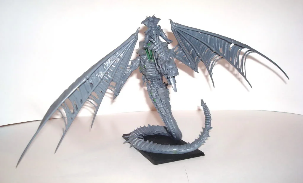

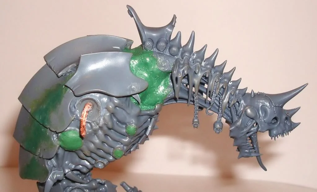

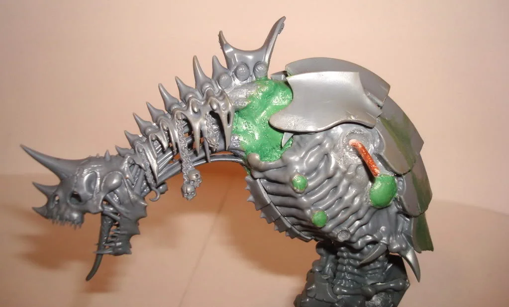

Abyssal Terror
Have had this in mind for some time, and I'm so happy it's finally done! :happy:
Well, technically there are still a few things to be done (some greenstuffing & improving) including the Lord, but this is basically it. It's in a usable state.
As you can see, I'm a tad megalomanic, but I can't help it. 👅 Yeah, every living (or dead) thing on the table will be able to see it in the shooting phase, but I don't mind.
Some technicalities:
Bits used: Trygon body & Zombie Dragon head + wings
Wing span: approximately 12"
Base used: 60x100 mm monster base (HPA, Screaming Bell...)
Waited for my magnets to arrive (they did today) to do the wings, but they were too heavy in the end, so they got pinned.
The tail is magnetized tho, so I can exchange it for other versions. The wings can be repositioned to a bit more open position, wider span.
Was hoping to make it possible to turn them reversly as well (similar to Terrorgheist), but without the magnets it ain't possible. Oh well.
So, here are the pics, C&C are welcome! ;)
View attachment 49600 View attachment 49601 View attachment 49602 View attachment 49603

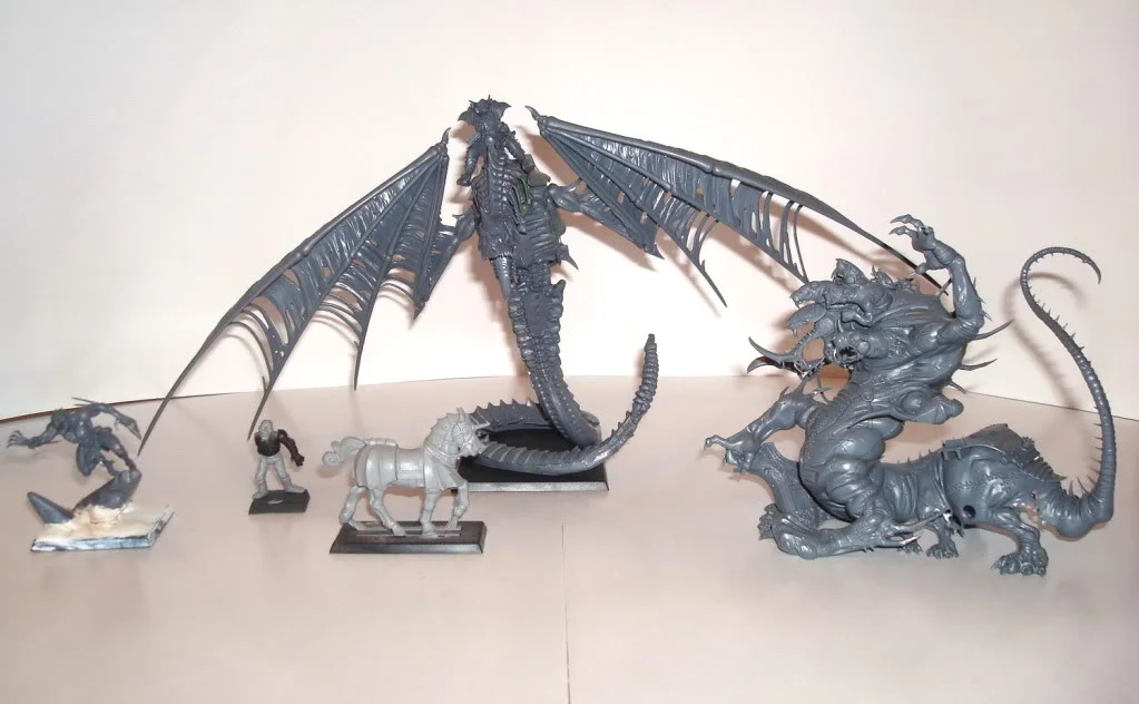

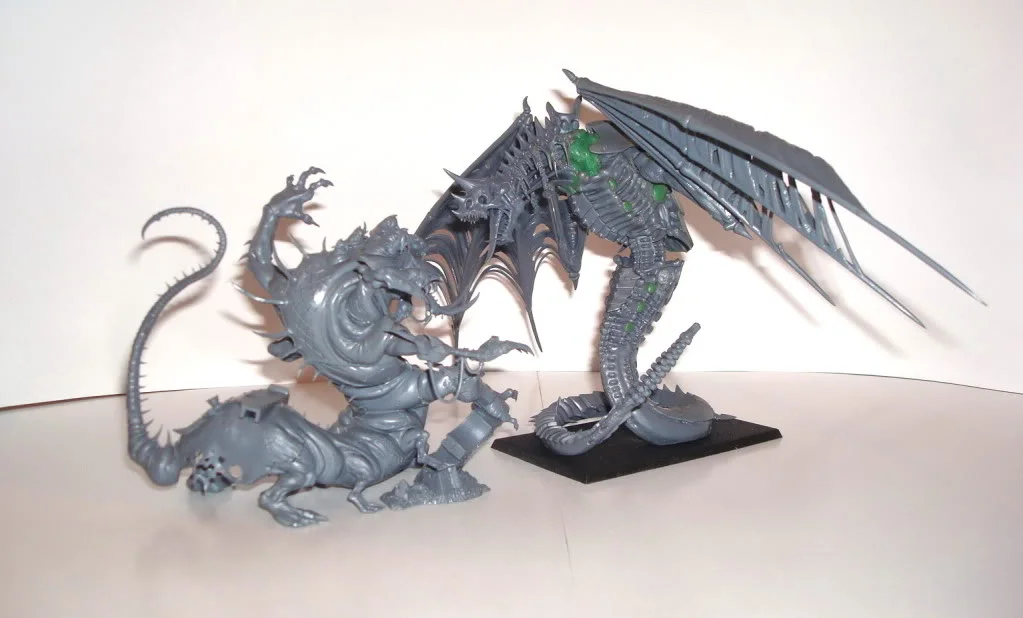

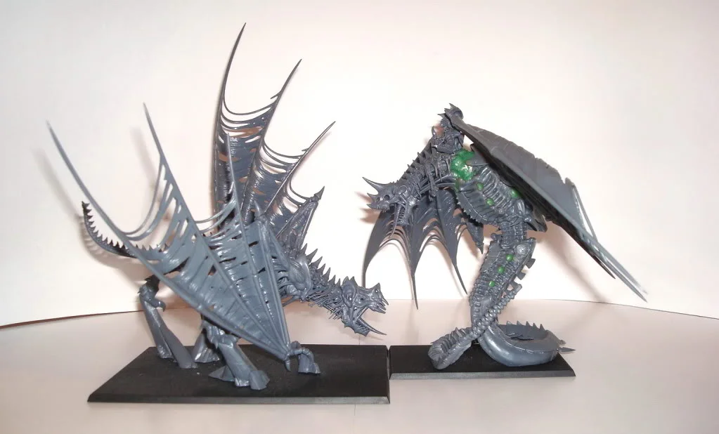

A few size comparisons:
View attachment 49607 View attachment 49608

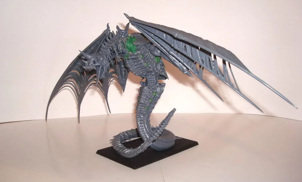

And some details:
:cheers:
