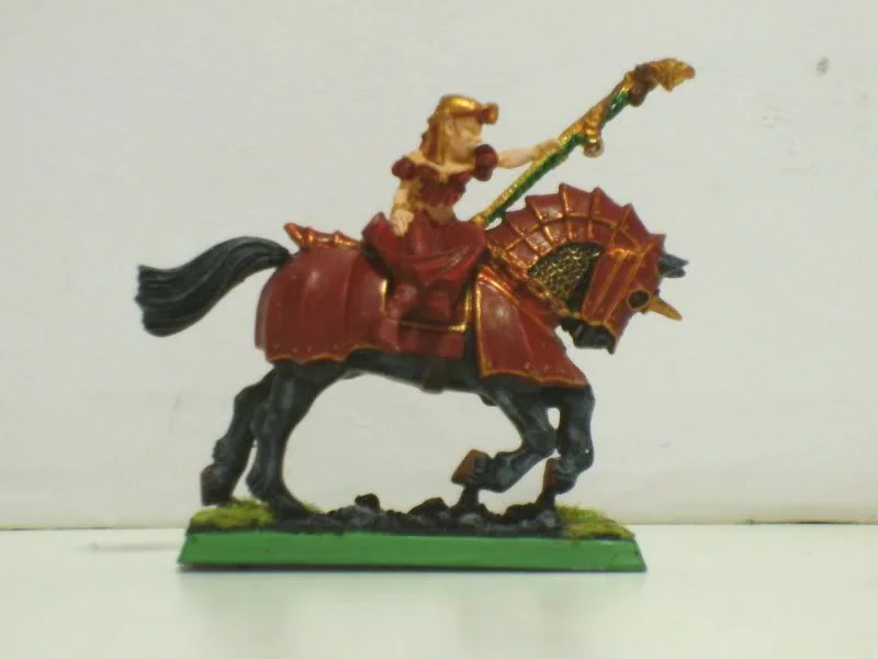

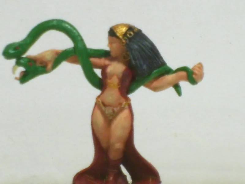

Many, many moons ago I posted some pics of my army so far with the disclaimer that I'm not much of a painter. At the time, I got some good feedback, and one of the constructive comments that came up more than once was that my characters were a little flat and lacked detail/distinction. For a couple of examples...
and
Sorry about the quality of the pics, but you can see enough to see that indeed, they are a bit flat.
One of the things that was suggested to me at the time, was apply a thinned out glaze to help bring out some of the details a bit more.
So I would like to get some advice on glazing. What is it, how do you do it, how does it work etc.
A few things that I should mention is the models are pretty much in a finished state, I just would like to bring some more (un)life and detail to them. But I don't want to have to repaint them all over again. Also, what they have on them now for their skin is just elf flesh, with a rotting flesh dry brush over the top. In 6th ed I played Lahmians, so I wanted them to have the look that they could pass for being alive. I'm not a fan of the grey, dead look, nor the purple dead look either. Nor do I want them to have a blue hue to them, or look pale white (though when I get around to doing Neferata, I might go for that unearthly pale white with her). Being difficult I know. Basically, I like them to look like they have just fed, with a healthy glow to them. I mean, going to war with your enemies, I would think you would feed well beforehand to make sure you had your strength up. I don't get going to battle in a weakened, decrepit state.. one should always look their best! Perhaps the Lahmian mindset has not left me completely :P

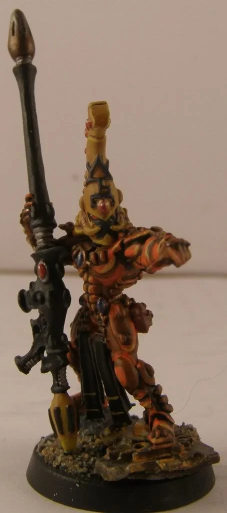

i used the flesh on the faces on these models.
i used the gryphonne sepia on the yellow helm

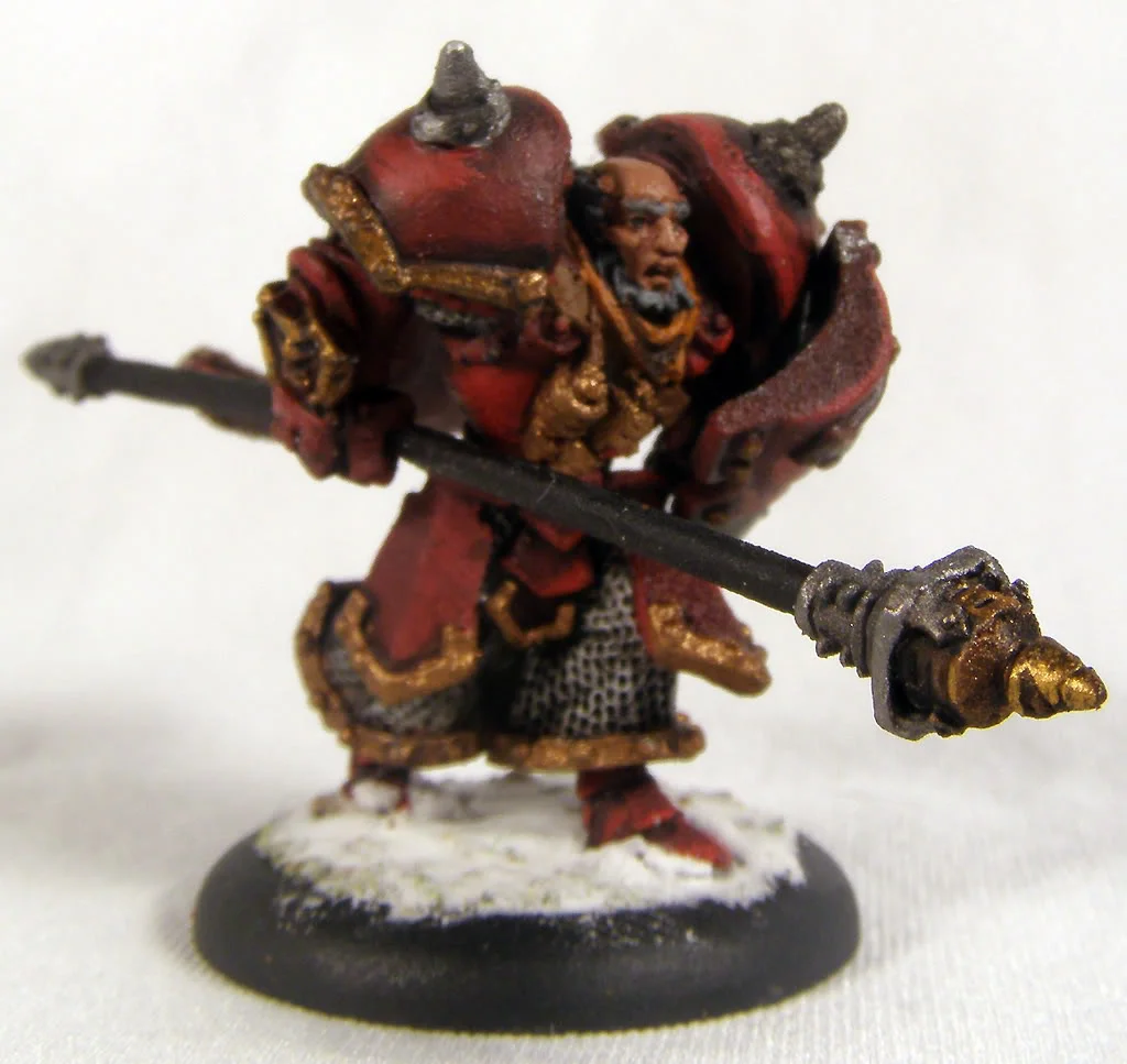

hope it helps also for the gold what i do is use brazen brass (stocked up when i saw that it was discontinued) with a highlight of shining gold then i wash the badab black over it and it looks nice heres an example.

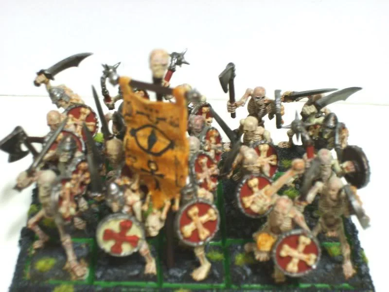

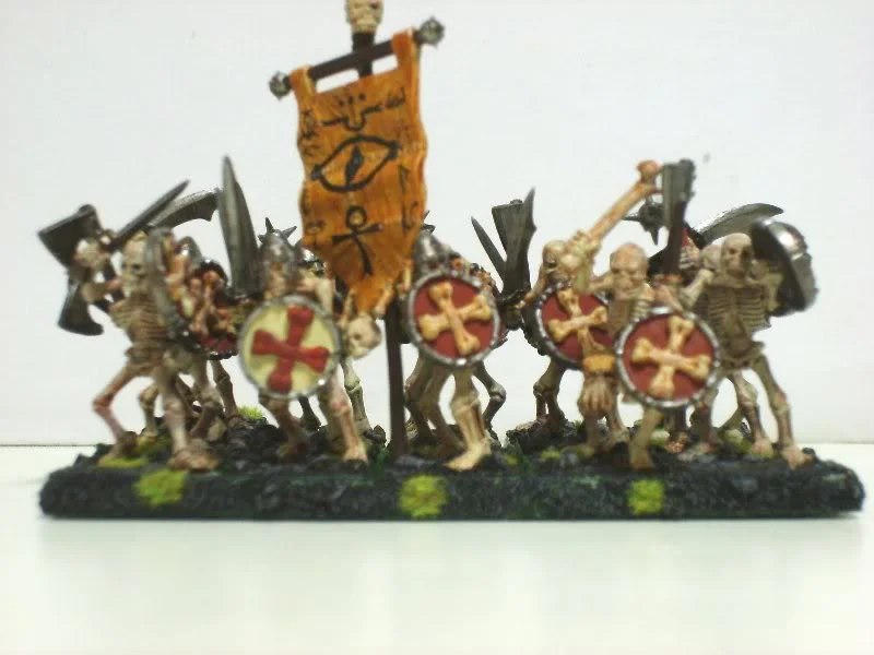

robh, I appreciate all your advice. I have utilised washes a little before (I think). With my skeleton warriors, I give them a basecoat of bleached bone, and then do a chesnut ink wash over the top, before drybrushing bleached bone back over the top, which gives this looks and effect.
I will need to be alot more careful with the washes on the characters though.. with the skellies the washes are applied very liberally. It was funny what you mentioned about pallid flesh as well being a better choice of colour. Just as the third character, the one with snakes, had Pallid flesh used on it. The mate that got me into the game 5 years ago (I'm a painfully slow, or procrastinating painter, I haven't picked up a brush in 8 months at least) had given me some paints to get me started, and had suggested doing elf flesh, and then pallid flesh drybrushed. Which worked fine. Except their was only a small amount of pallid flesh in the pot he had given me, and by the time I got around to the other characters, it had dried up, and then GW had discontinued it, so I thought I would try rotting flesh as an alternative. So to get the same colour as the old pallid flesh, how would I go about trying to achieve that?

DE: Pallid Flesh is a slightly pink colour which you could achieve by mixing a tiny drop of Scab Red with an drop of white then add in elf flesh drop by drop until you come to a colour you are happy with. Remember to thin the paint slightly before you use it. (By drop I mean the amount of paint that will drip off the non hairy end of a paintbrush that has been dipped into the paintpot)

Those skeleton warriors look fine.
