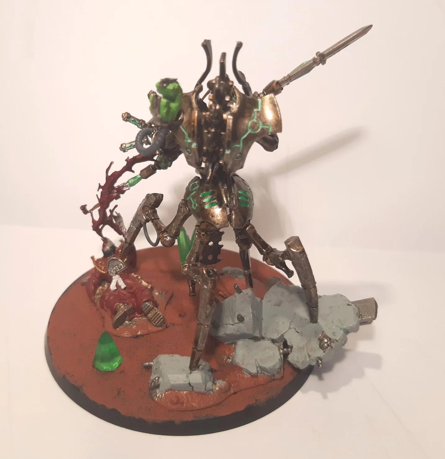

Unas the slayer Thanks so much my friend! I really like your Szeras. Very threatening pose and the integration of the green crystals on the base is a cool idea. Is there any chance you could get some better pictures of it? It can be a bit hard to see, which is a shame <3
Maybe this evening I will try to take some other shot with a different source of light. 😊
Szeras also looks very cool. I think I just want to see something more on the open areas of his base? maybe some (or more?) texture paint/more built up basing or something.
I'm trying to improve on the whole "basing" process. i've spent too many years just using black bases (or primered ones).
For my bases I like to fill bare patches with texture paint using GW's "M Texture Spreader" - basically a tiny plastic spatula. It's a bit flexible, which makes it work easier than like a knife or metal sculpting tool, while being firmer than a paint brush to make it easier to spread the paint around. GW's texture paint is fine but pricey and gives a more grainy surface. AK Interactive's texture paint comes in a variety of surface qualities and are more cost efficient in a larger tub - though drying out is an issue, so I use some plastic wrap pressed down onto the paint in the tub to cover it before screwing the lid on when I'm not using it, and I stir it up with like a popscicle stick or whatever before each use. With texture paint you can build it up in layers if you want it to be thicker so long as you give it time to fully dry. You can also sprinkle patches of fine slate in while its wet or press in some skulls or whatever for extra texture variety or additional details - though it's a good idea to apply a spot of thin superglue after its dry to hold bits like that in.
I like to apply texture paint before painting, but usually after gluing the model on, though some complicated models are better painted separately if it'll be easy to see under them but hard to reach with a brush. Then I just paint the base as part of painting the model, and apply additional details like grass tufts or snow effect at the end. other people prefer to paint the model first, then do texture paint - picking a color that starts close to what they want the basing to be, and either leave the texture paint as is or wash or drybrush over it for some extra depth while being careful to avoid the painted parts. With something like your green crystals you'd probably want to go with the 'paint first, then glue crystals, then texture paint' order.

I do really like the brownish-black oily quality of the silver bits, and how they blend with both the black details and goldish bits. Especially the black sort of collar structure that frames the head. It gives the overall model a grimy feel to it that goes really well with the modern necron techno-geigery aesthetic, one that comes accross much better in the newer pictures and should make for a very cool army on the table.
