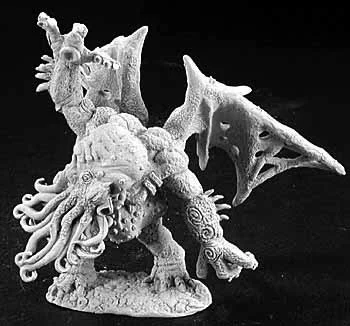

Okay, I have to ask: where's the head from your abyssal terror from?
RE: Devo's Painting Log -- Updated 3/21/10
The head comes off of the Reaper Eldritch Demon.
