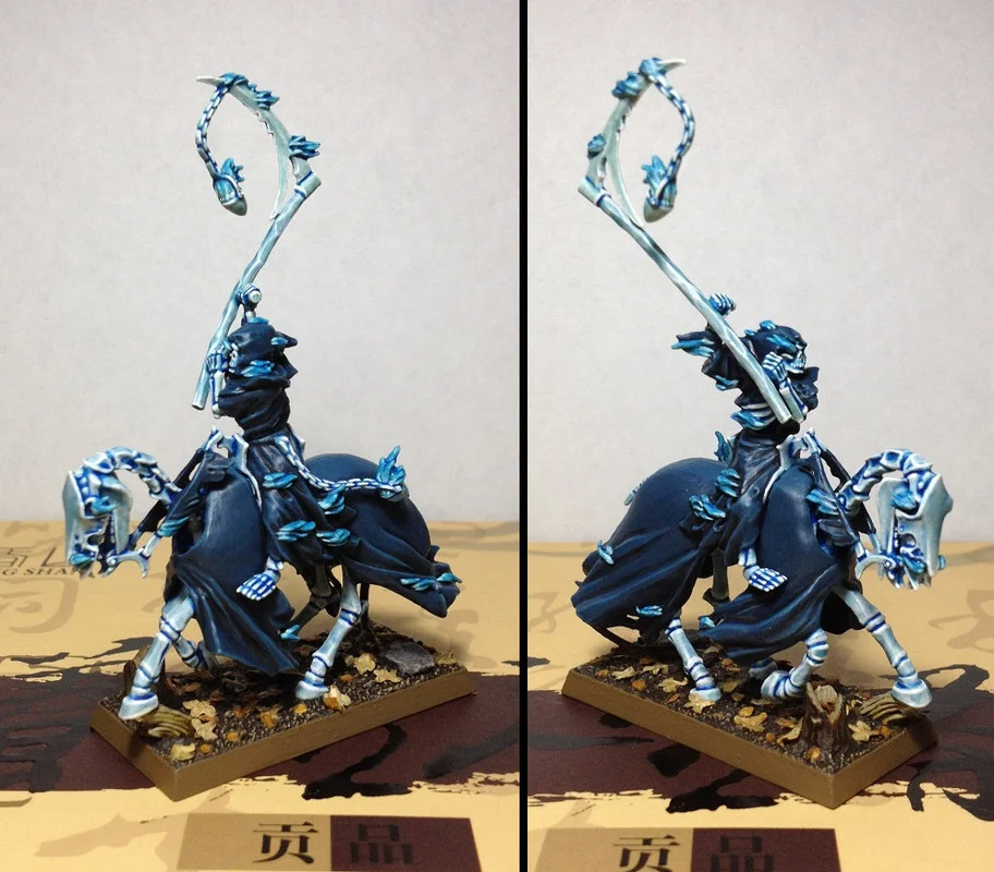

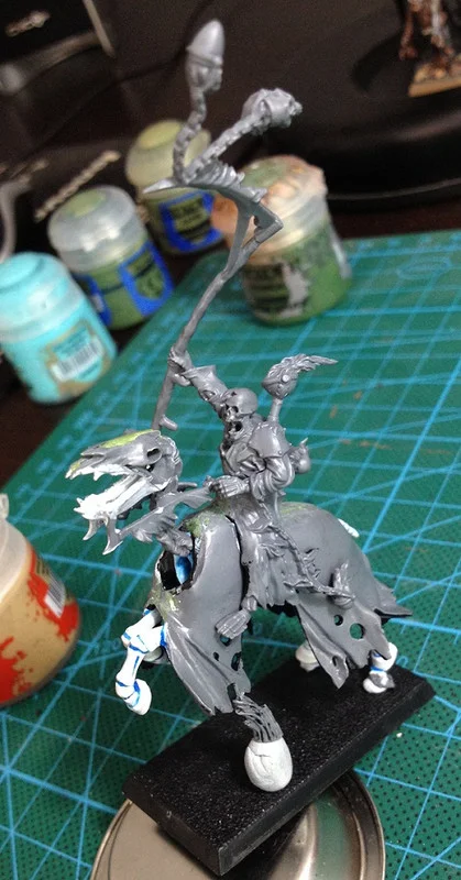

It's been ages since I've gotten anything done, but here we go - my Hexwraith concept mini:
Just like the Cairn Wraith, dark blue robes, blue flames and light blue everything else.
Some more shots:

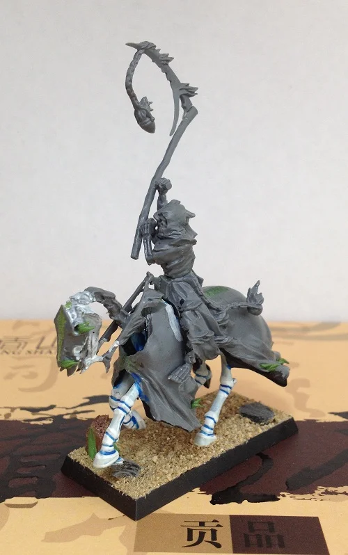

And here's the before shot:
I green stuffed flames on the horse's eyes & snout and also on it's robes, nothing big but having blue flames over the entire miniature instead of just the rider makes it look better I think. I'm happy with the mash of blues at work here but still think my fire needs improving, so hopefully I can hone my skills on the other 4 Hexxies I've got in the works.

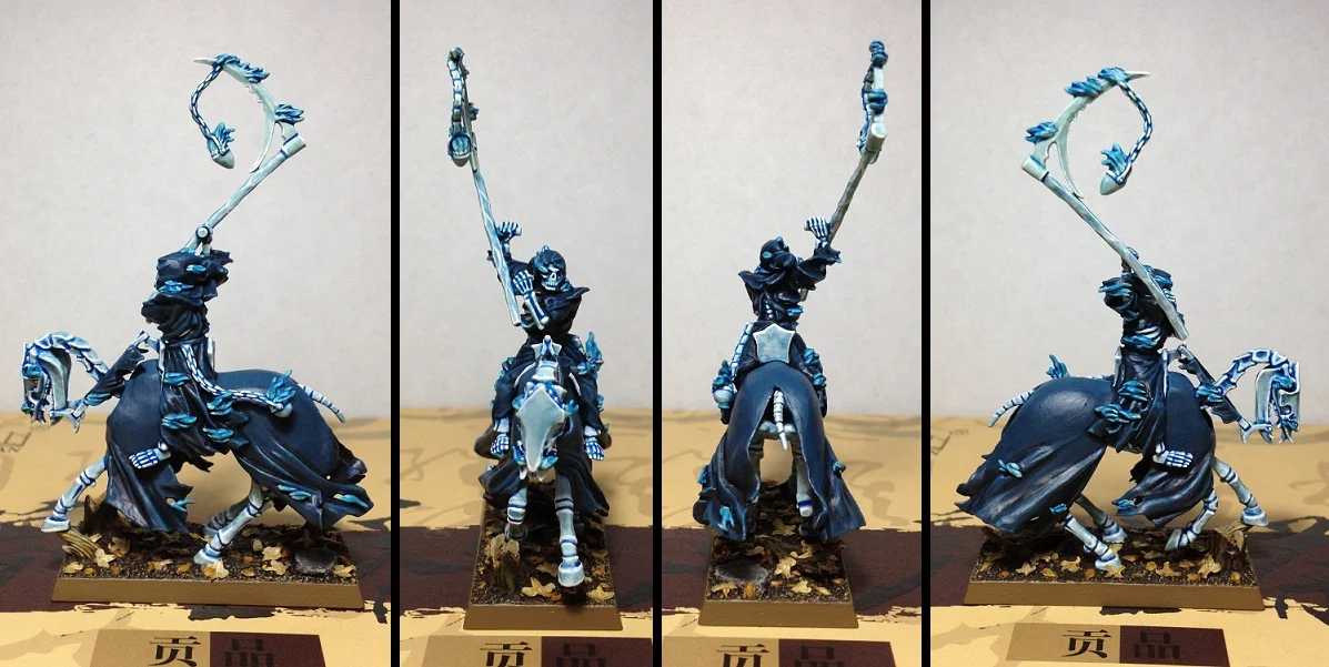

I've also been assembling the wraiths and have decided to make the Hellwraith stand out a bit more by elevating his mount a bit:
Not very clear from the angle I took the shot but he stands out amongst the others quite well.

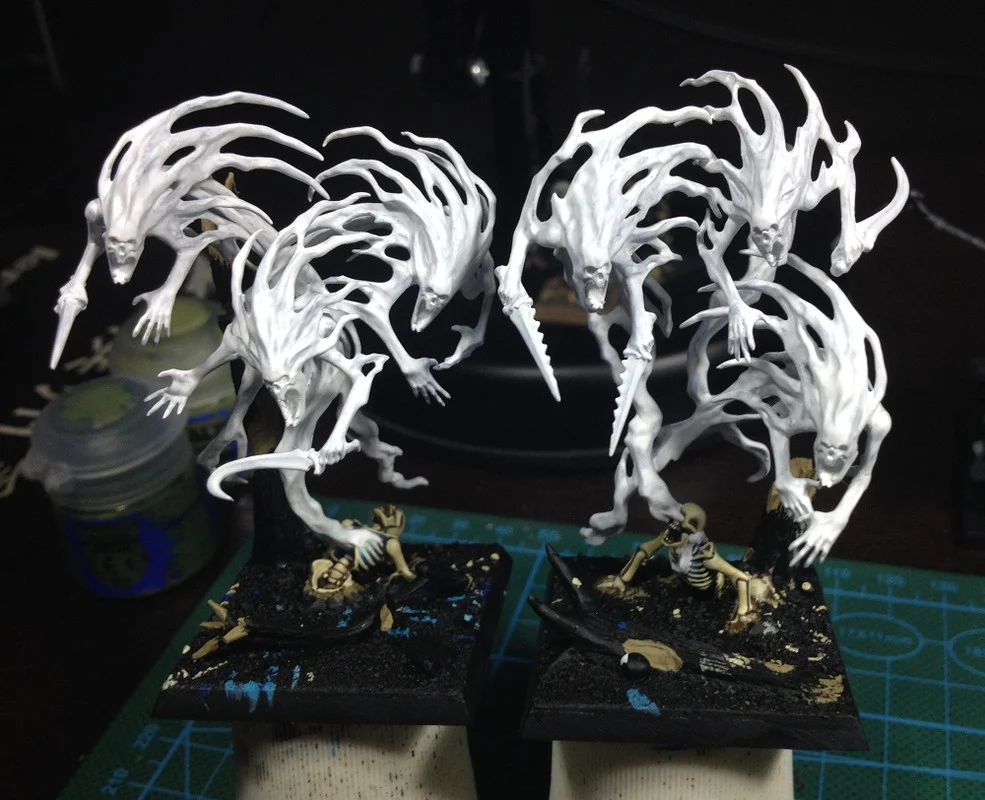

Here's the two spirit hosts that I've been working on over the past few weeks:
A before shot:

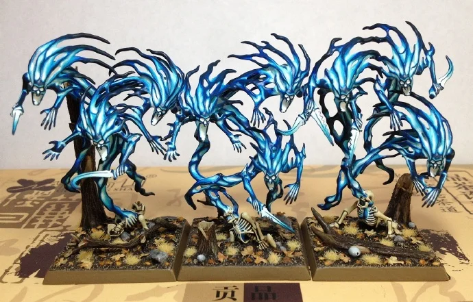

And then the whole unit together:
They took a bit more time than I usually like to spend on three miniatures but the end result makes it worthwhile. They're awesome sculpts but have zero alternative pose options - that got me thinking about some cool conversion ideas, so the chances of me doing another box of spirit hosts later on down the line are pretty good.

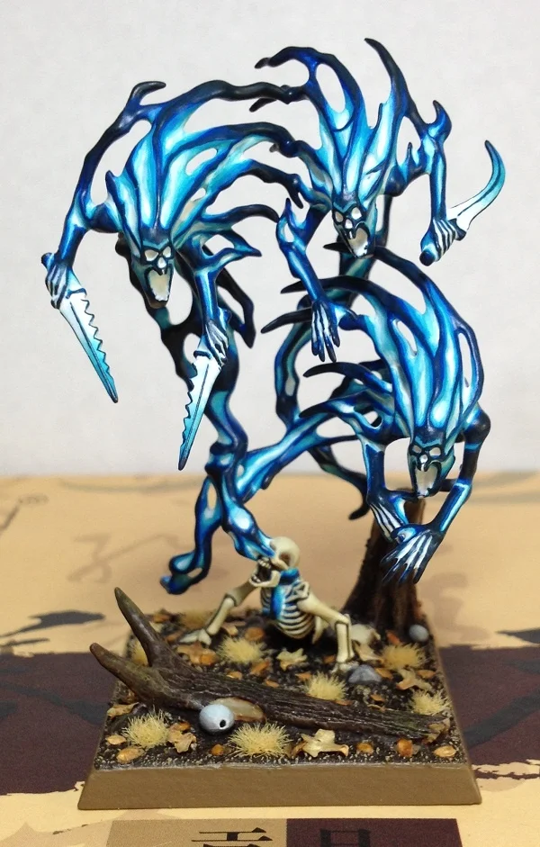

For anyone that might be interested in this scheme I took step-by-step pics of the spirit hosts this round, so here's a guide I've been able to put together.
Farmer's Spirit Host Tutorial:
Before painting I prepared & assembled them as normal then filled the spirits' eyes & mouths with greenstuff.
1/ Undercoat the spirits white. I used Vallejo Surface Primer and applied several thin coats.
2/ Basecoat Baharroth Blue. Again, a few thin coats work nicely.
3/ Wash Vallejo White Primer 1:1 Water (or medium) - don't let it pool too much or you could get these ugly white rings when it dries. You can enhance whiter areas by applying the wash several times (allowing it to dry completely each time). This is actually how the inner half of the strata on the blades is created.
4/ Layer the majority of the miniature with Baharroth Blue 1:1 Water (or medium). Be sure to leave the deepest areas white, and to not apply too much paint around these areas to give you a nice transition between the tones of blue. Remember to hit the weapon blades too, to start creating the outer half of the strata.
5/ Repeat the previous step using Temple Guard Blue 1:1 Water (or medium). Remember to be careful to keep the transition as smooth as you can.
6/ Layering again, but this time using Teclis blue 1:1 Water. This is the last colour I layered the blades with.
7/ Go over the spirits again with Caledor Sky 1:1 Water. I didn't layer the blades with this.
8/ Same again with Incubi Darkness 1: Caledor Sky 1: Water 2. I used this colour as the main highlight on the weapons' edges.
9/ Incubi Darkness 1:1 Water for the final layer on the ghosts. I basically used this on the highest parts of the miniature – the face, weapon points, fingers, etc. Things like that.
And there we have it, after basing them I end up with this:
