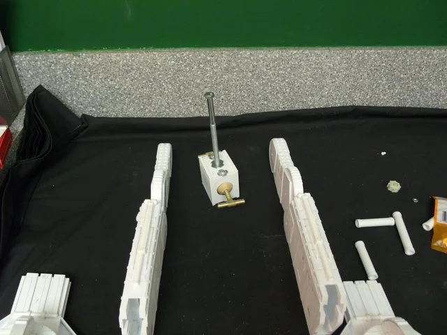

I just finished reinforcing the top and bottom of the block with 3mm scrap plastic which will give plenty of strength to this all important area as small as it is it must take all the weight and movement from the above structure and also the legs.
Theres a 10 inch 3/8 ths diameter inch bolt threaded through 'Tee' nuts top and bottom and the for to aft hip gimbals are mounted with 10-32 screws through 'Tee' nuts as well. There is a 7/16 dia. inch tube inside of a 1/2 dia. inch tube as a compression spacer that the pivot rod runs through and the whole is strong enough to stand on if you don't weigh 18 stone.
Now that I've taken the pictures I can seal the gimbals in under their cap plates and the pelvis will be completed.

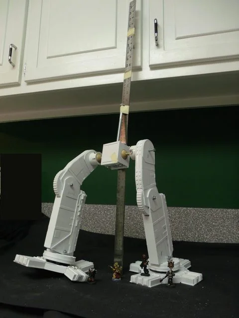

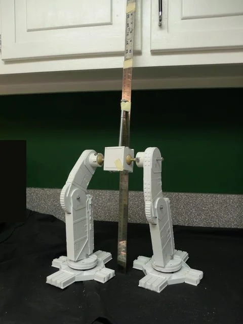

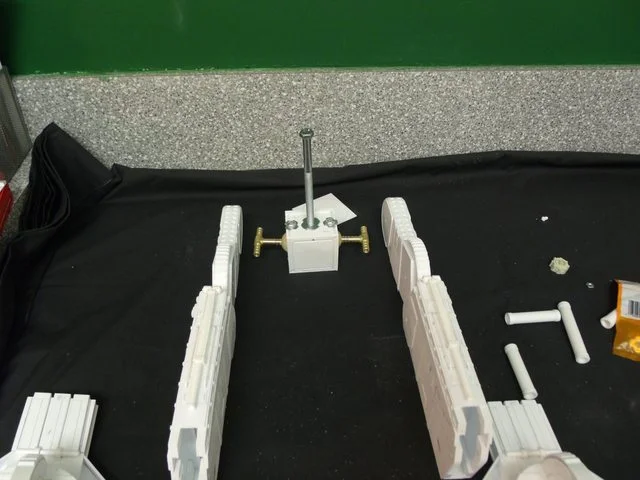

Okay let's recap for the week to establish where we stand. The pelvic block is basically done and the legs are basically done except for the detail.
Now the cross 'Tees' are temporarily in place to establish the width of the hips and allow for the splaying of the legs ala the 'classic Reaver pose'.
I figure I should get this in before the weekend as I will be working on the 'hip articulation' whilst everyone is off having a life for the next few days.
I can see already that my greatest fear has been allayed and the pelvic block is not too big and that I actually have to increase the width of the hip joints once the hip gimbals are installed.
For that I shall have to employ a couple of PVC fittings to house the spheres and fill them with resin so they will take a thread much in the manner of the Lucie hip joints but this much larger model gives me the luxury of two articulation points instead of one that the limited space in Lucie provided.

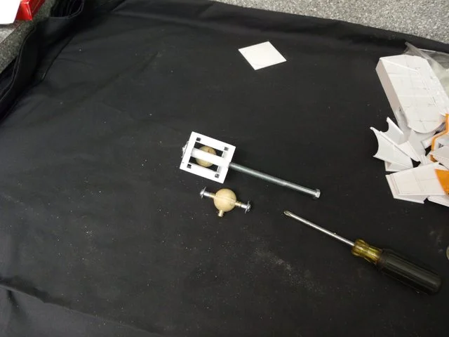

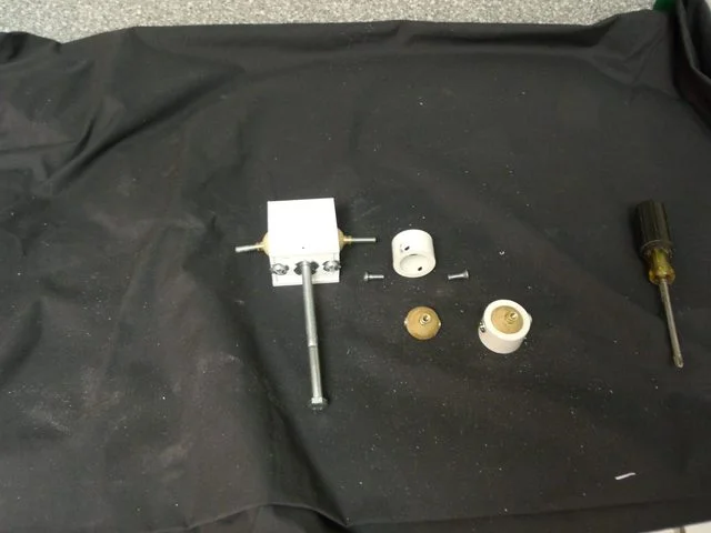

Now we will further address the manufacture of the pelvis/hip attachment.
I found some ideal PVC 1 inch pipe nipple to PVC tubing adapters that fill the bill for the hip joint ideally. There is even an internal shoulder ridge after the threaded portion is cut off to act as the race flange for the gimbal sphere to be retained by.
The remaining sleeve is drilled, tapped, and countersunk to receive the 1/4 inch axle screws............ (I apologize for the American Standard measures but there isn't the diversity in metric hardware available on this side of the pond for me to render this in metric components.
There may very well be metric items that equal or exceed the materials used but they are not available to me .).............
As I was saying, using only 1/2 the hip sphere it leaves ample room for the epoxy plug in the end of the sleeve to be threaded and hold the leg attachment screw.
I hope to achieve this later today.

Note the degree of flexibility that can be achieved with this setup. Stops will have to be added to cut down on this amount.

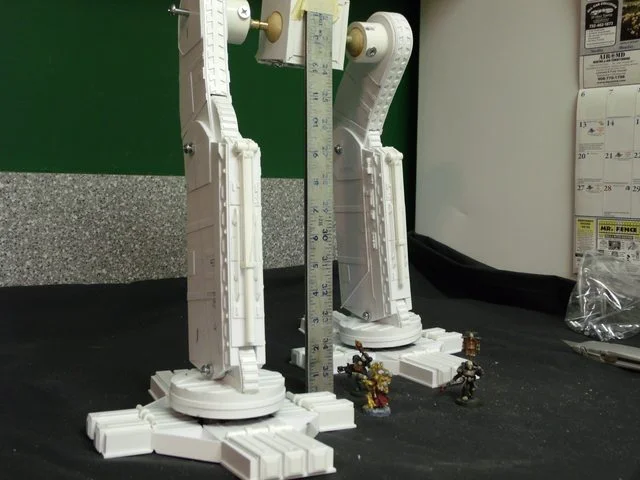

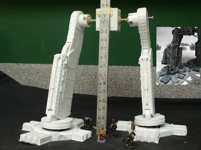

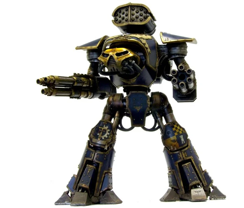

Time for the weekly recap along with a pic in pic comparison with the DS model.
I have to admit waiting for the resin to dry consumed a lot of the production time but I worked my butt off to get to this stage and it's a testament to the durability of this thing that nothing snapped as I slapped the components together.
Now I know the legs look a bit thin but if you look at the comparison shot and mentally remove the armour and spurious hydraulics there is a reasonable case for verisimilitude.
The images are self-explanatory when taken in conjunction with the recent WIP posts but I can explain any area that anyone might be unclear about.

This is a very bad pose but it does demonstrate the flexibility of the design.
http://i.imgur.com/NVgrW.jpg
A pose reminiscent of the classic Reaver stance.
http://i.imgur.com/I8lZN.jpg
http://i.imgur.com/Mkwk0.jpg
A pic-in-pic comparison with the DS model.
http://i.imgur.com/pUzzc.jpg
