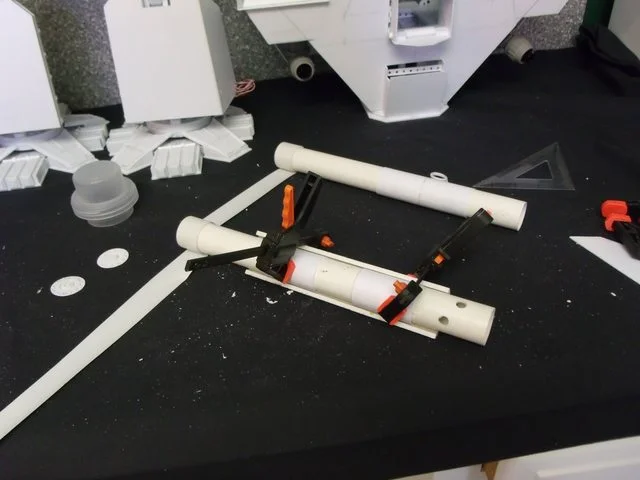

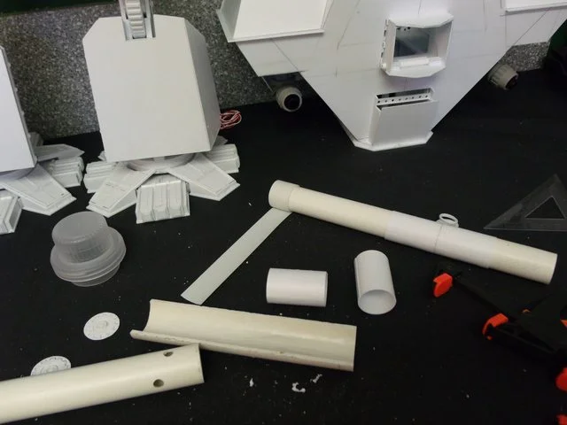

Starting with a full sheet of 'Evergreen 0.5 mm styrene I divided it into 6 equal parts of 50 mm width. The reason for this is that while bending a 50 mm wide strip tightly around a PVC tube is well within my capacity bending evenly a 150 mm sheet is not; you may prove better than I at that endeavor.
http://i.imgur.com/QWafC.jpg
Once I have a proper overlap wound and cemented I opted to glue the remaining tail of the strip on as well for seam reinforcement.
I now had 6, 50 mm long tubes of the required diameter.
http://i.imgur.com/xzn0f.jpg
Sliding the relatively near perfect tubes back onto the PVC tube and mating the seams I applied a liberal amount of cement on the periphery of the seam I pushed the segments together until tiny beads of plastic oozed from the seam and allowed to dry the result being an extremely light near perfectly round 150 mm styrene tube to build my gun barrels around.
