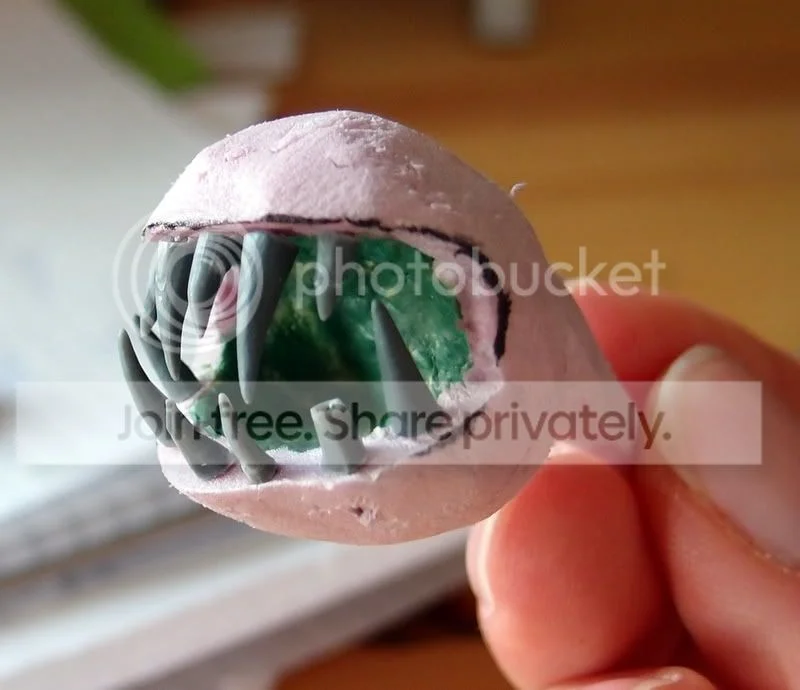

From the styrofoam you construct the base shape, a ball with an open mouth (if you want one). Try to make the mouth nice and hollow, carving it out with a small knife (the knife end of the GW sculpting tool is great for this). The inside gets a little rough after this so you probably want to cover is with putty. In the pictures I've used green stuff but on the ones I'm making now I've used milliput which was great for it. The thing to remember is that it doesn’t have to be that nice since it wouldn’t be very visible due to all the teeth. You might also want to add a tongue. I make these from putty with a base of steel wire. Make a very basic shape first and then add detail in a second session. Here is a pic of it can look thus far:

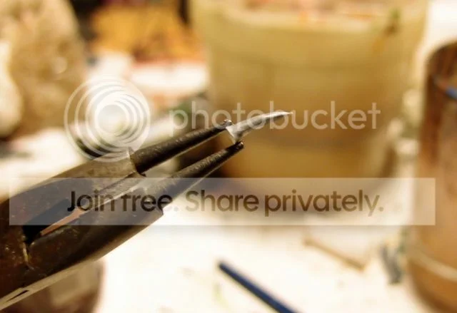

If you have an open mouth you then add teeth, I make these from sprue frames. Just take the plastic and cut it to shape, drill a hole in the bottom and pin it to the jaws. Here are some pics of that:

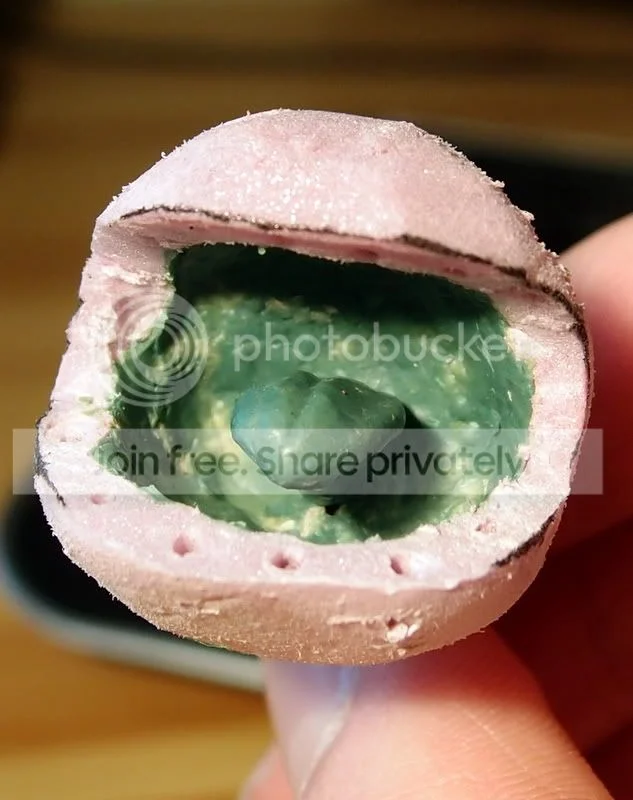

Next you sculpt the gum. First cut away the styrofoam around the teeth to make a round base for the gum. Then add green stuff. Sculpt this quite far back the body (it will help the next stage) and don't care about lips yet. Cause that is the next stage. Lips are added by rolling a string of green stuff and attaching it on top of the gum. On the upper lip the string is flattened, making a smooth transition into the skin beyond (i.e. that part of the gum you sculpted a stretching a bit back the body). The lower lip gets a little bit of this treatment, but you still want to to stand out more. Near the ends of the line you smooth it out though.

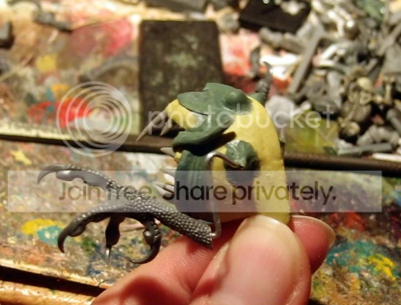

Onto legs. Drill a hole through the body where you want the legs attached and pull some sturdy steel wire though. It can be a bit tricky to attach it properly since the styrofoam is so soft. On my new squigs I pulled the wire through and added milliput on either side, pushing it into the hole next to the wire, to make it a bit sturdier. On the warboss's squig I worked a piece of plastic into the centre of the head, the wire goes through this piece and it is also where the warboss is attached with a magnet.
Bend the wire on either side to give the shape and pose of the legs. For proportions I used the existing squig models and just doubled each length. I then covered the wire with twine, as a cheep and lightweight way of bulking out the muscles. Here you can see the legs thus far, and the work on the lips:
