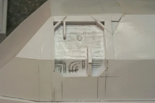

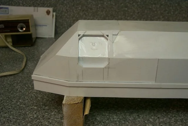

Department of one step forward and two back. Discovered an error in my building of the air brake panel recess. Had to tear it out and redo it. Two days and I'm back to where I was two days ago. but the cavity looks a lot better and that's what counts.
The slightly insane Blackadder
Note that the recess is now lined with 0.10 x 0.250 inch strips and the inner wall echoes the outer shape of the superstructure. You don't? well no one else would have either and I just pissed away my time rebuilding that which no one would have noticed anyway.

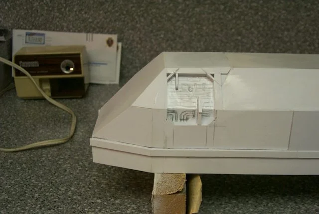

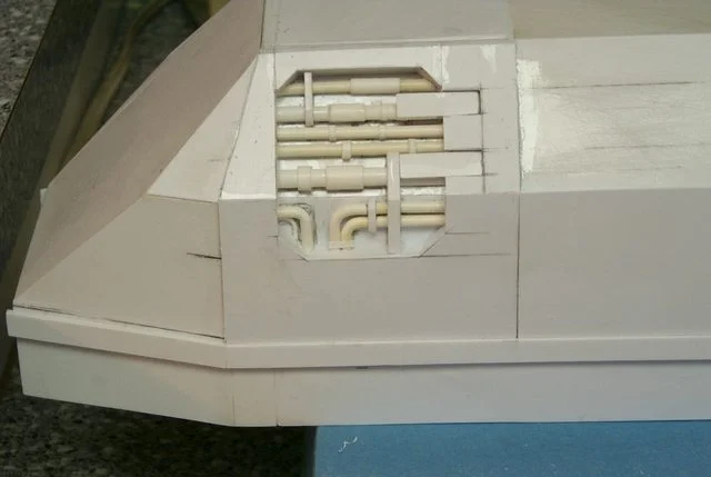

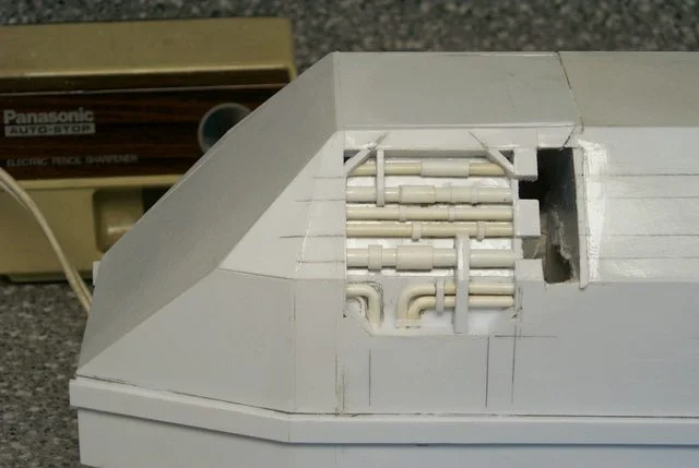

Another peek into the skunk works. Out of this hodge podge of scribbles I hope to extract a semblance of order and replicate the internal plumbing.
I hope I have enough scrap tubing.
E. Blackadder

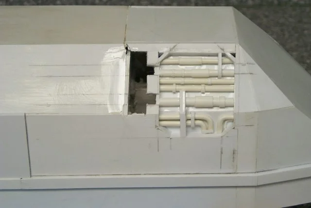

The plumbing installed, a lot of pipes for such a small area. I suppose fuel lines and tubes for air conditioning and pressurization. Too high for lavatory waste pipes.
The right side:
And the left side:
E. Blackadder
Enough resting on my laurels; there's nothing difficult about this detailing.

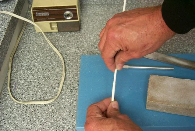

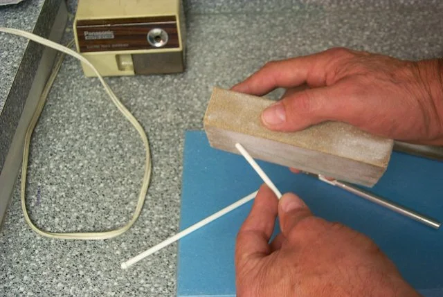

The thin pipe is actually made from old plastic flower pot hangers. you know the kind that have the hook moulded into them. I saved a bunch of them years ago and I'm soon going to be running out.
I used styrene rods for the bending and bent them with a pair of needlenose pliers. The trick is for more leverage to bend the rod before you cut it. Then over bent the angle and flex it back to the angle you want. Styrene fatigues quickly and should hold it's bend when glued in place.
Here's a short tutorial on pipe fitting.

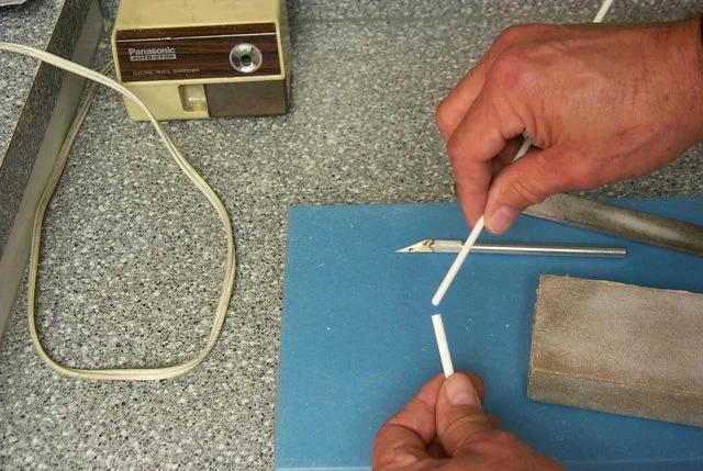

The simplest is to just cut rings in the next size larger of the Evergreen telescoping tubing. Slide the ring onto the smaller rod or tube and glue in place with ProWeld thin cement. No need for pictures of this process, But.......

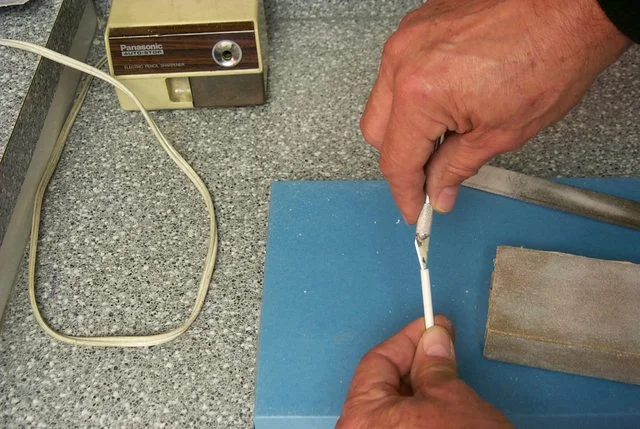

sometimes you want a really thin sleeve on your tubing.
First file or sand the smaller dia. tube to a tapered end:
Then with a thin pointed Xacto blade ream out the larger dia. tube:
to receive the previously tapered rod or tube:
Join the two tubes and cement and set aside to dry on a flat surface:

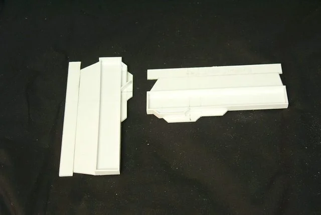

Cutting out the hull was the hard part, another step backwards but it had to be done. A 2 mm bulkhead to strengthen the casement and
to provide a secure mount for the hinge assembly. the cutting out the hinge recesses which gives me this result and no significant damage.

Dude...those pipes look amazing. I love the effect you've achieved with them. And the method you used is so simple...it makes me wish I played Space Marines so that I could put some exposed cooling pipes onto my vehicles. xD

Back to the hinges:
The hinge installed shown in the closed position:
The hinge in the open position:
Sink me, it works!

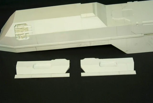

I'll be finishing skinning the fuselage this weekend.
I wouldn't have thought that such a seemingly simple moving device could have consumed so much time but at last it is done except for the door panels. I managed to sheath the lower hull and around the brake openings on both sides; not too far behind my expectations for the weekend in spite of having to work a bit.
Rather pleased at the symmetry and the very close match of the left side and right side structures:
The open position, a tad larger than the 3D image but it's a moving part.

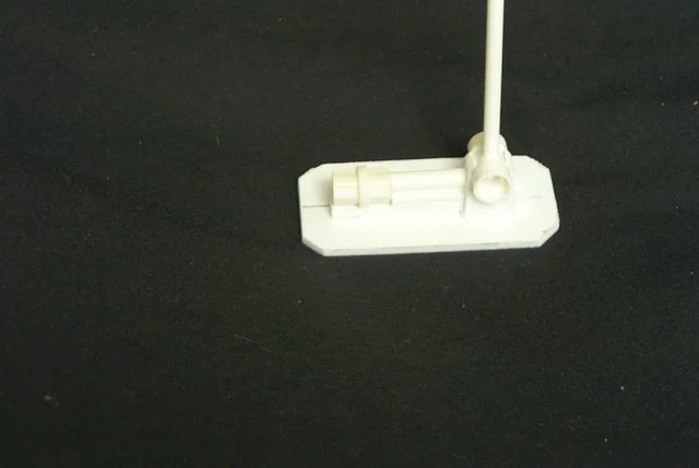

The wing root mount plate and engine mount tab outboard with one piece temporarily tacked in place to demo the approximate position. I think it's too far forward but that is the beauty of modular construction for once they are assembled I can place them where ever they appear correct.
The landing gear wells are coming along quite nicely. I've had a thought to build each wing separate from the hull and mount them with screws for easy disassembly for transport. This will be quite a large model and damage will occur if in one piece.
http://i.imgur.com/tpPDe.jpg
The gear well and landing pads scale = 13 ft X 7 ft per pad or 4 meters X 2 meters if you like. We now begin the excursion into attempting to build the retraction mechanism.

The resolution of the foot pad is pretty pitiful but this is what I gleaned from it.
http://i.imgur.com/xOrIU.jpg
http://i.imgur.com/W2i3Q.jpg
The gear temporarily installed in gear wells to check for clearance and operating space. There appears to be sufficient room and the struts remain within the hull instead of poking out through the wing root :D whew!

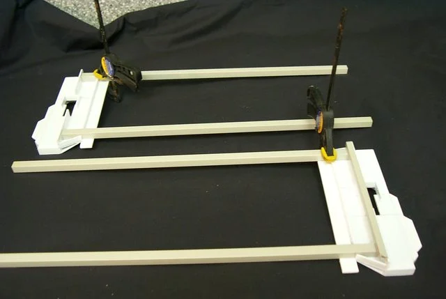

Back when I was building Lucie I bought some gray ABS plastic box beam tubing manufactured by Plastruct. I don't recommend using this stuff but I've got to get rid of it.so I'm using it to frame the engine mounts and the wing core assembly. It's stronger than styrene but doesn't cement well with styrene glue unless you rough the surface up with sandpaper. Or you could use ABS cement which I believe is mainly acetone.
http://i.imgur.com/3ydfP
http://i.imgur.com/TPmC6
Before you get your 'nads in a knot the just installed beams will be cut very short; they're just left long for now to insure they are parallel. That is a building hint; it's easier to insure frames are parallel and true if they are long than short. The discrepancy in trueness is easier to detect with the longer length.
We're starting at the ground floor building the wings so there shouldn't be any question later on how it was done. Now if I can just do it without a mistake.

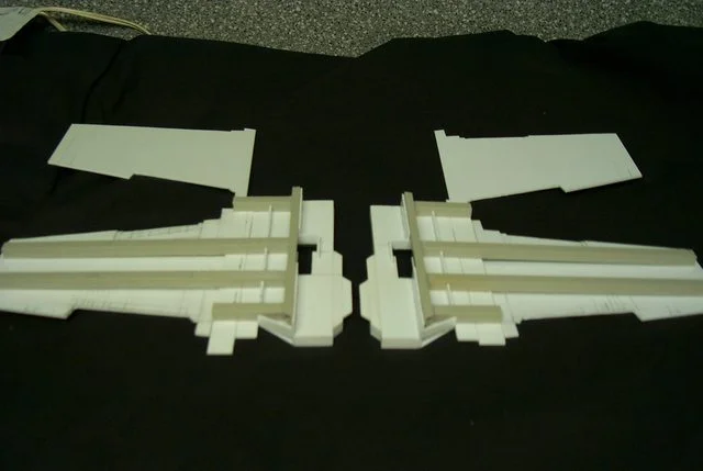

I calculated the wing outboard of the engine should extend 17.5 mm excluding the wing tip armament That seems a bit small to me but figures don't lie. We'll just have to see I can always make them bigger.
Thunderhawks have always had slightly short/stubby wings, which is kinda part of their look. (Most Marine flyers, like the stormraven and landspeeders share this trait)
Thanks for the reply,

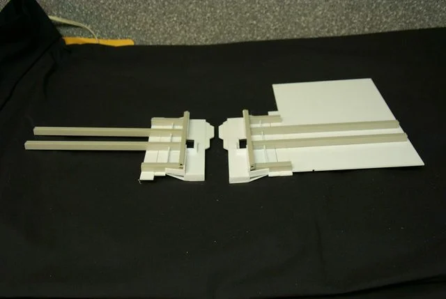

The wing core plates in 2.0 MM styrene cut out and ready for install.
http://i.imgur.com/3H6Ul
http://i.imgur.com/NAmz
